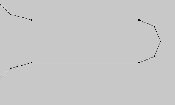

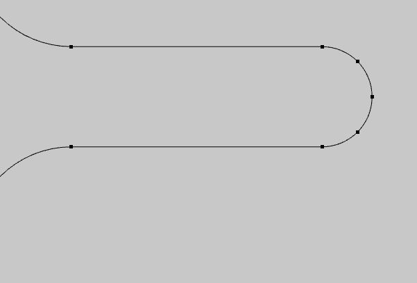

I am trying to generate a difference between two objects and keep the subtracted object which is arrayed with fine features. However, due to the order of magnitude difference in size, resulting object has sharp corners. Is there any way to fix this?

Thanks Robert, I increased the feature size and the issue is resolved.
