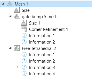

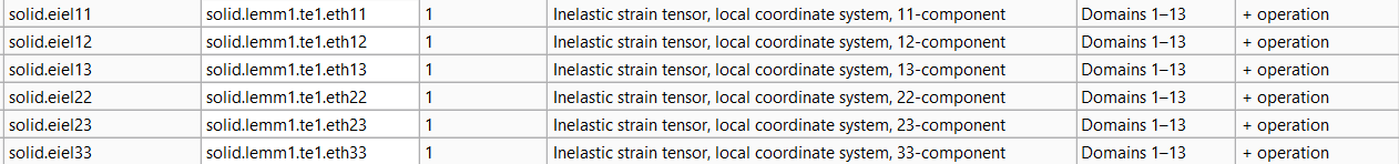

hello Duanhui, please check the mesh quality and initial values before computing.As in the uploaded mph file the mesh quality is not good enough.In the uploaded images you can see information 1, information 2 ........ please check those and for your reference i have attached the image where it says "Failed to find consistent initial values". I hope it helps.
