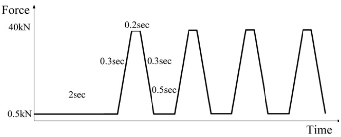

  1. How can I impose the following time dependent load on the surface? Note: Frequency is 0.77Hz.
