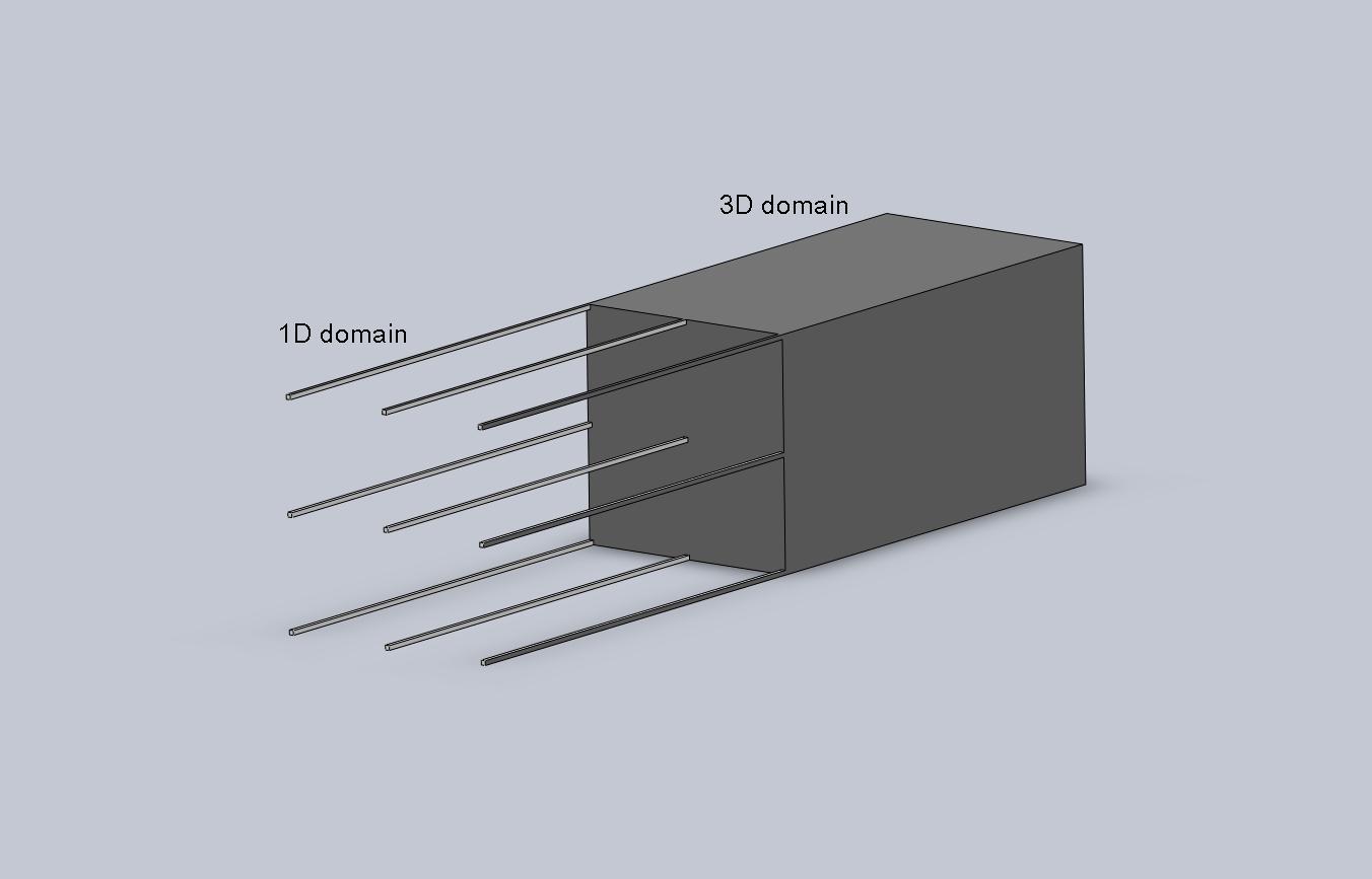

Hi everyone,
I would like to couple a bunch 1D domains at each and every point of a 3D domain boundary (2D surface). See the attached .jpg to understand.
Here is what I tried until now for a simple conduction problem :
1. I work in 3D.
2. I draw 2 adjacent 3D cubes.
3. I set the boundary conditions, etc.
4. For my 1D domain (1D in theory, drawn in 3D), I do this:
In Physics\Equation System\Subdomain Settings\keep only the terms for 1 coordinate (the one normal to the boundary) in the Weak equations and the Variables equations.
It solves quickly, no error messages, but I have to validate my solution. It looks a little weird to me since 1D nodes should be aligned, and here I still have tetrahedrons with unaligned nodes...
I can't find nothing related to my problem in the integration-extrusion-projection coupling variables theory.
François
