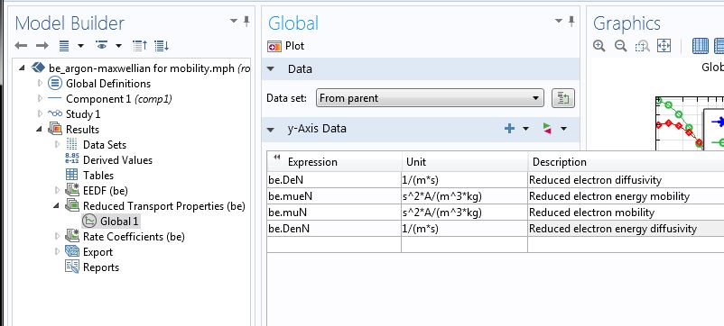

I hope I do not have to change anything for the mobilties/diffusivities? it is not clear where to look for that?
the exports are documented (see file)
I believe these are also the import units..
