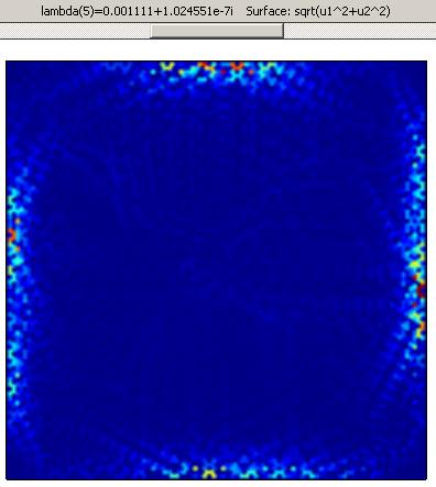

I am trying to simulate graphene using Dirac equation in 2D. First, I wanted to try something simple like free particle and particle in a box using Dirac equation (rather than Schrodinger equation). I used PDE modes -> PDE, Coefficient Form -> Eigenvalue analysis. I put 'u1 u2' as the dependent variables and enter the coefficient as in the Dirac equation. For boundary condition, I specified 'u' to be zero at the boundaries (particle in a box).
However, the result that I got indicate the energy level (eigenvalues) as complex numbers and the wavefunctions spread out to the edge as attached (not form a standing wave pattern as expected).
I don't know what wrong with the model. Note that, I tried with Schrodinger equation and it works. So, the differences are only the equations in subdomain.
