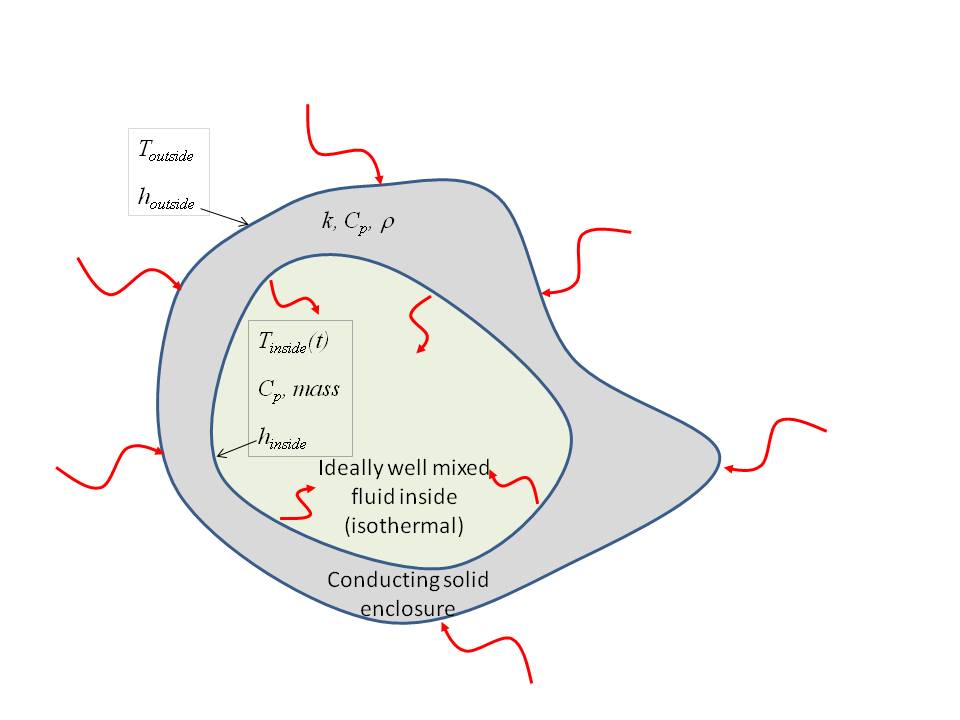

I want to solve a simple transient heat transfer problem where a volume of fluid is fully enclosed by a solid container, all with constant physical properties (see attached). Heat is transferred from outside to the solid then on to the enclosed fluid inside. To avoid solving a fluid flow/convection problem on the inside I can assume that the fluid is very well mixed and is isothermal at any time.
My goal is to calculate the fluid temperature as a function of time. I need to set the problem with a Neumann boundary condition on the inner boundary but the inner (fluid) temperature will need to be determined from solving a separate integral equation of the sort mfluid*Cp_fluid*(Tinside(t)-Tinitial)=time Integral of heat flux on the inner Neumann boundary.
1- How best do I set up this problem with the auxiliary time integral to set the inside temperature?
2- How do I initialize the fluid temperature (remembering that there is really no computational domain associated with it)
