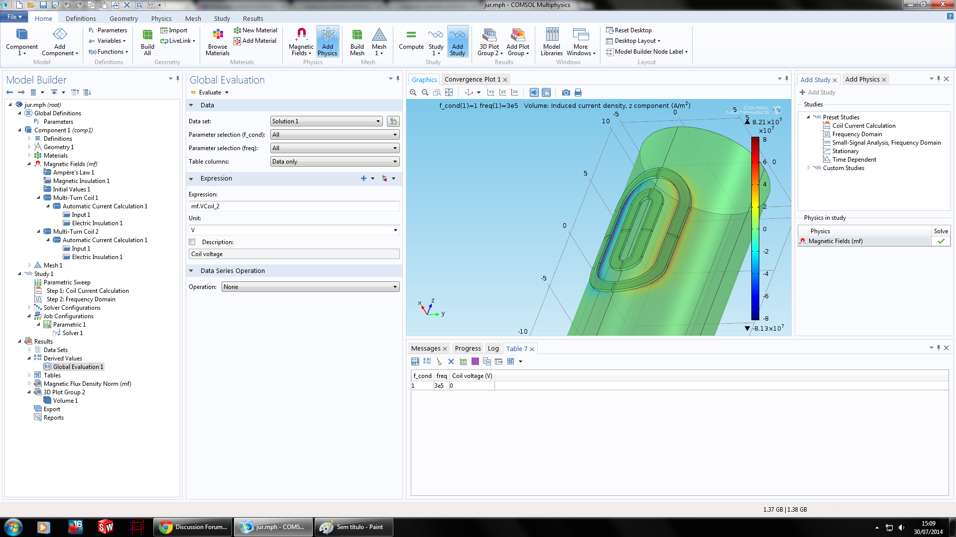

no current incuced in my inner coil.
Posted 2014年7月31日 GMT+8 02:10 Low-Frequency Electromagnetics Version 4.4 3 Replies
I am trying to find the induced voltage on my coil wich is induced by another external coil, both are multi turn coil and numerical, they are over an alluminum bar, they are concentric and the inner coil has a current equals to 0 and the external coil has 1 [A], I have added the input and an electric insulation in both and in the step I have a coil current calculation for the external coil and also a frequence domain, but my global evaluation keeps showing me a voltage equals to zero in my inner coil, does anyone know what I am doing wrong?
