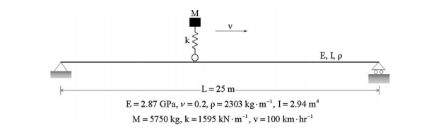

Any tips on how to implement a moving sprung mass on a simply supported beam? I know to how to correctly implement a moving load, but not a moving sprung mass.
thanks!

The model is in 3D, but using a single beam element simply fixed at both ends, not a cantilever.
Yes, I am envisioning a point mass attached to the beam through a spring of some sort; for the first attempt, I am just assuming vertical (i.e. the direction of gravity) components of displacement, no rotations. For the spring I guess I am assuming a vertical (soft) and lateral (very stiff) stiffness. So at the contact point (or area) of the beam, the displacements would have a quasi-static part due to the weight of the mass and a dynamic part due the beam-mass interaction. The mass travels at constant speed (and slow relative to sqrt(E/rho) of the beam).

you image looks more like a 2D beam problem, with a pinned - rolling BC for the beam, the material and beam, parameters defined E, nu, rho and L & I, and a moving mass M of velocity v with a spring Ky on a rolling point in contact to the beam.
So most of the physics is described, a few hypothesis are missing or considered implicit, I understand them as: the horizontal velocity of the mass M is NOT influenced by the spring, only the vertical Y axis motion of the mass.
A point remains open: should the rolling spring to beam contact be a one way contact and allow bouncing ?
I would propose to start with a fixed contact point and avoid "contact physics" as this is tricky to make to converge, then it should not be too difficult to check that the wheel is not bouncing and lifting off the bridge, if so, then its worth to try to implement a contact model as the vibrations of the beam will change drastically if the Mass gets disconnected.
I see two ways to implement the spring and mass,
1) use a point mass at the end of a small beam you adapt to have the right stiffness Ky, that is constrained to a constant velocity along X
2) add an ODE (or modify the Prescribed Displacement node) to describe the Ky & M combination on the contact point moving at constant Vx velocity via mechanics equations
