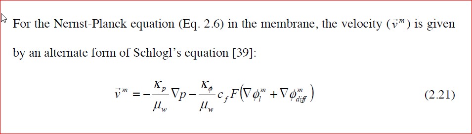

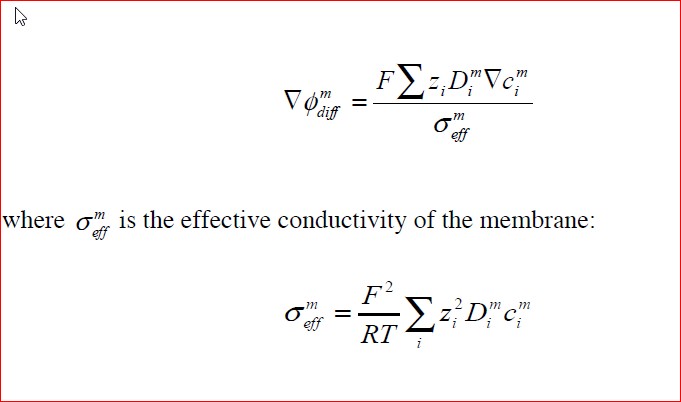

I want to use an equation which is an extended form darcy law to calculate the velocity in the membrane of a cell.
The equation are in attached jpg file. I don't know which physics to use. Can using darcy law physics will serve the purpose, if yes then how can I customize the equations for the darcy in the given (attached file) equation form.
Please help if anyone finds it relevant.
