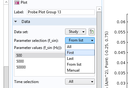

I' running a simulation in ac/dc model (2D) and i want to compare the current density in a domain point probe for different frequencies for my input signal. if i do a parametric sweep i and wanna plot the results i have the opportunity to plot the 2d plot for the different parameters using the dropdown menu. if i wanna do this in the 1d probe table graph it seems that its not possible. i attached a screenshot; i can choose the frequencies in the probe plot group but cant plot the current density over time in a table graph for each frequency individually.

Thanks for the quick reply. I checked the manual but to be honest i dont know what to do with it. Where do i use the "with" operator? can i stick to the approach of using a parametric sweep for the frequencies and plotting a table graph based on the accumulated probe table ( which does include all the necessary data )?if so, where do i use the with operator?

for more details. the model:
time dependent study, ac/dc, analyzing current density in conductive media in a domain point probe, applying a sinusoidal signal and adding a parametric sweep, for different frequencies.
now my question is, is there a opportunity to plot the current distribution over time for each frequency. if i add an accumulated table i have all the data i need in one table, but it seems impossible to plot the signal for each frequency individually.
Please help me :) I m lost with this simple task, i know it should be quite easy to export the data to matlab, but im sure there s an option within comsol?
