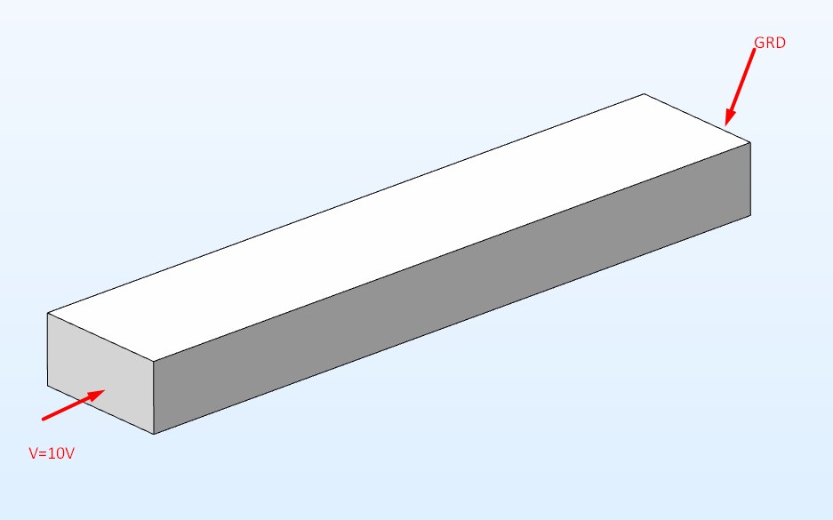

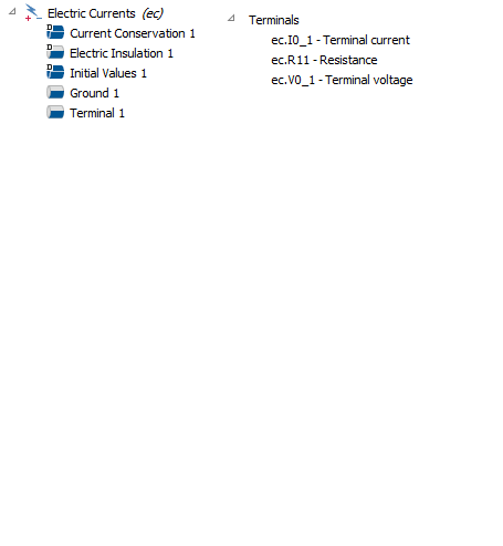

Nic,
You can use Terminal boundary condition to calculate resistance between two surfaces, as shown in the attached image.
Regards, Sergei
Nic, You can use Terminal boundary condition to calculate resistance between two surfaces, as shown in the attached image. Regards, Sergei
