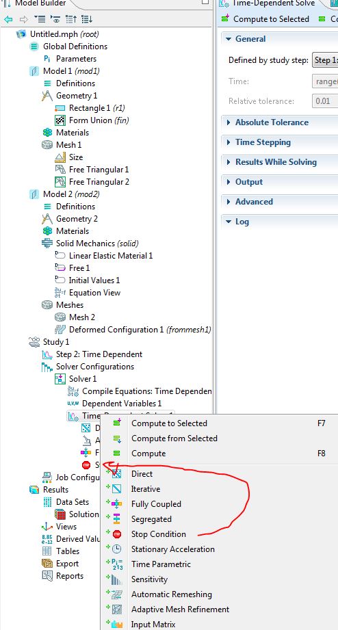

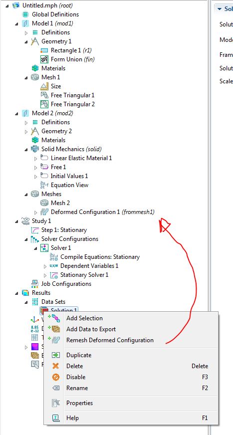

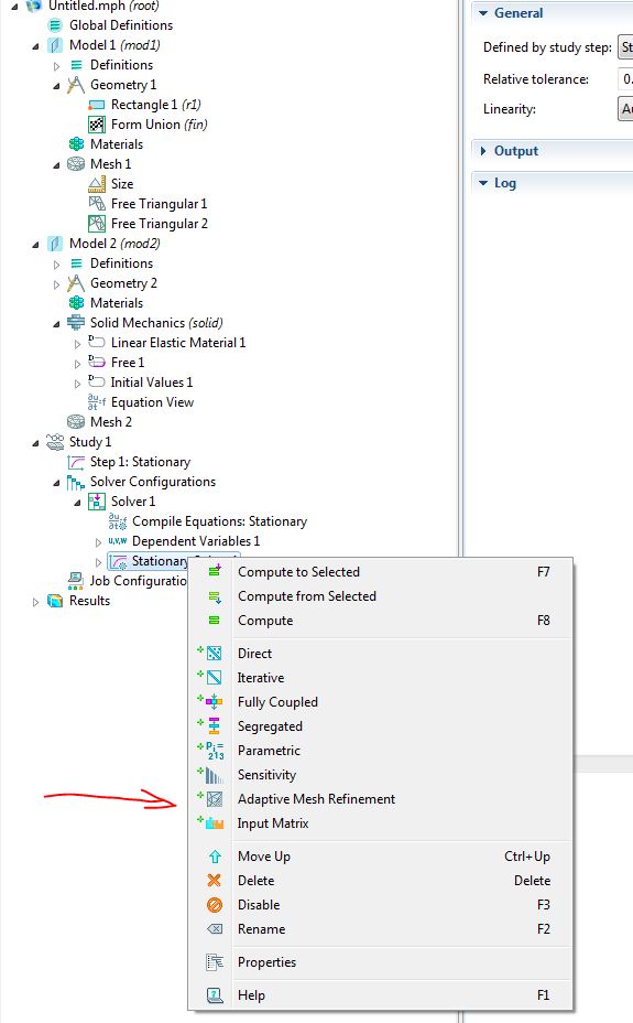

You can access the mesh commands under the solver nodes (try a right click), see also below

Thanks, Ivar.
I looked at the attached images, but they refer to deformed meshes or to a time dependent solver. My problem is different, and will try to explain it a different way.
My underlying problem is that I cannot get convergence during a parametric sweep of inlet flows on a stationary 3D fluid flow problem. I am looking at flows of 100:100:1200 mL/min, and it only converges up to about 500. The Reynold's number is only 1900 at the max flow, but the geometry results in some disturbed flow patterns leading to non-convergence. I suspect I can get convergence with a finer mesh, but I cannot determine what part of the mesh is giving me a problem and needs refinement. So what I would like to do is run the parametric sweep with increasing flow until it fails convergence, then adaptively refine the mesh. Then I would like to restart the parametric sweep. If the sweep succeeds, then I am done. If not, I would like to refine the mesh again and repeat this process until the sweep succeeds.
With this approach, the solver stops when it fails convergence and therefore cannot continue to the adaptive mesh refinement. Is there any way to make this work?
As an alternative, and perhaps a better, approach I would like to run the adaptive solver at each step of the parametric sweep. That is, the sweep would start at 100, solve it, refine the mesh, then move on to 200, refine again, etc. But I could never set up the adaptive mesh refinement to operate inside of the sweep. No matter how I set it up, it always runs the sweep inside the adaptive solver.

Sorry, but here I cannot really help that much (try support) I'm fighting with something similar these days too, and need more time to be comfortable with the "dynamic" meshing and re-meshing options, these are features I haven't had to use too often, and things has changed over the recent v4 "evolution" (far more detailed options)
