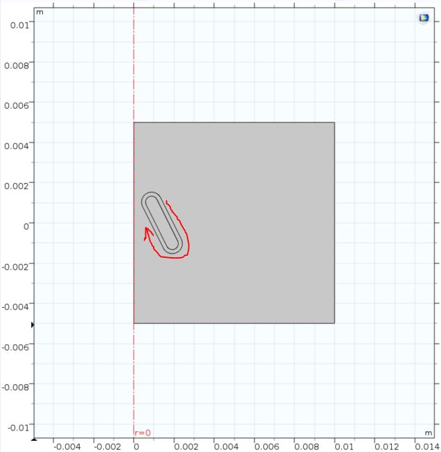

mef: 2D Axisymmetric coil current direction
I have built a 2D Axisymmetric model with Magnetic and Electrical Fields (mef) mode. The structure is simply a coil, as is shown in the image. However, when I try to add a coil in the mef physic, there seems no way to specify the current direction as is shown in the image like 3D model. It merely set the default current direction, which is not what I want. Would you please tell me how to solve this problem? Thanks for your help!

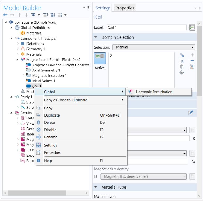

Dear Mr. Shaikh:
Thanks for your reply! However, I still don't know how to set the direction of current, because there seems no such option when I right clicked on the coil node.
