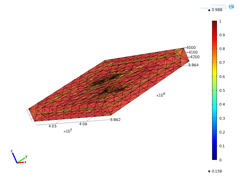

I have a 3D model, and I would like to cut it exactly into half to check out the elements inside, under '3D plot group', I choose 'mesh' and then choose 'select cut plane normal from surface' from the top, then...? it seems to have no button for me to click to plot further? (please see attachment)

in COMSOL there are two basic ways:
1) you prepare the cut plane in the geometry with two domains (the "layer feature is handy for that") this interiour boundary will respect, by default "continuity of flux conditions" so it does not really make your moe much heavier. And you will have nodes placed on the surface by default, hence flux or gradient calculations might be slightly more precise than the next case. Furthermode, the oundary is easy to select and you can set up variables define on the bondary. All this is done BEFORE you solve
2) you define a "Data Set - Cut Plane" on the solved daa. This makes availale a surface sub-data set onto which you can do postprocessing. As this plane mostly cuts through mesh elements, the values are interpolatd to be defined on the cut plane, this can lead to a slightly les precise or sagged values for the variables. This is a pure POTPROCESSING domain operation. You can define a surface plot on this (sub) data set
Hi in COMSOL there are two basic ways: 1) you prepare the cut plane in the geometry with two domains (the "layer feature is handy for that") this interiour boundary will respect, by default "continuity of flux conditions" so it does not really make your moe much heavier. And you will have nodes placed on the surface by default, hence flux or gradient calculations might be slightly more precise than the next case. Furthermode, the oundary is easy to select and you can set up variables define on the bondary. All this is done BEFORE you solve 2) you define a "Data Set - Cut Plane" on the solved daa. This makes availale a surface sub-data set onto which you can do postprocessing. As this plane mostly cuts through mesh elements, the values are interpolatd to be defined on the cut plane, this can lead to a slightly les precise or sagged values for the variables. This is a pure POTPROCESSING domain operation. You can define a surface plot on this (sub) data set -- Good luck Ivar

many thanks! I tried out the 2nd workaround, it works good!
yet, it seems to be no difference from defining a slice as postprocessed interface, because under 'expression', I do not have any extra options but only 'Geometry and Mesh \ coordinates; domain index; mesh element size; mesh quality; volume scale factor'. Indeed, I need to visualize all individual elements when I cut through the domain itself.

COMSOL does not really give you direct access to the mesh elements or nodes, but to your dependent variables extrapolated onto entities (such as domains, boundaries, edges, or points) be these true geoemtrical items or postprocessing features
