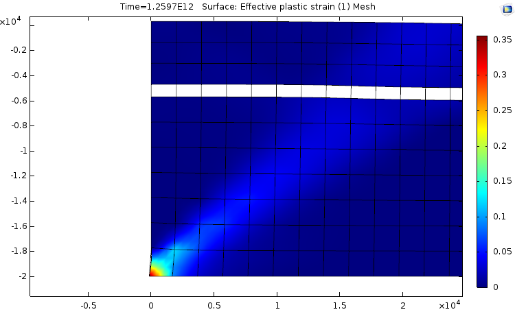

My model is running well until a certain time, when plastic deformation just blows up at the left bottom corner. My first guess to explain this problem is the conflict between the left BC(fixed in y and x ) and bottom BC (fixed in y but moving at with a velocity of -0.8 mm/yr in x). Indeed, the left bottom node will move at the speed of 0.8 mm/yr toward the left, whereas the node just above is completely fixed in both direction. This implies that the element in between those two nodes is highly deformed and gives crazy plastic deformation to finally stop the model.
I was wondering what i should do to get around this problem at the left bottom corner, in order to allow my model to finish the computation (or at least, run for a bit longer)?
